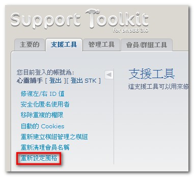

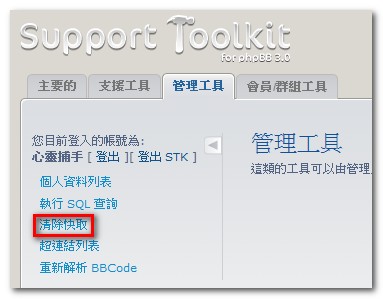

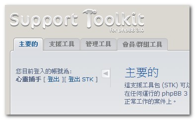

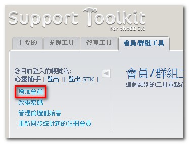

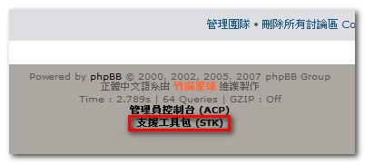

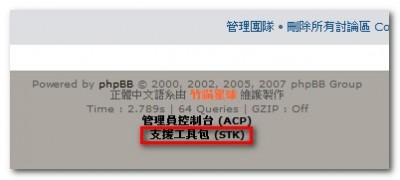

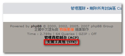

擷取圖片:
  • ACP 首頁 (此連結需額外安裝)
  • STK 首頁
  • 支援工具
  • 管理工具
  • 會員/群組工具
  • 論壇頁底 (此連結需額外安裝)

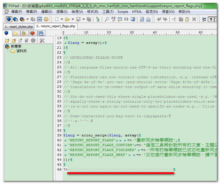

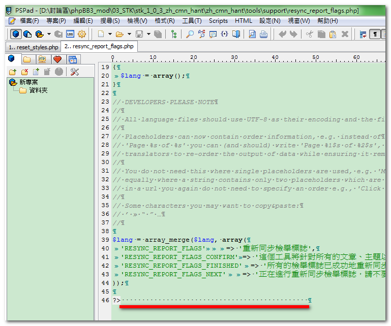

[工具] Support Toolkit 1.0.3 中文檔修正
說明:
使用支援工具時,頁面會出現錯誤訊息,如下:
[phpBB Debug] PHP Notice: in file /includes/functions.php on line 4617: Cannot modify header information - headers already sent by (output started at /stk/language/zh_cmn_hant/tools/support/resync_report_flags.php:46)
[phpBB Debug] PHP Notice: in file /includes/functions.php on line 4619: Cannot modify header information - headers already sent by (output started at /stk/language/zh_cmn_hant/tools/support/resync_report_flags.php:46)
[phpBB Debug] PHP Notice: in file /includes/functions.php on line 4620: Cannot modify header information - headers already sent by (output started at /stk/language/zh_cmn_hant/tools/support/resync_report_flags.php:46)
[phpBB Debug] PHP Notice: in file /includes/functions.php on line 4621: Cannot modify header information - headers already sent by (output started at /stk/language/zh_cmn_hant/tools/support/resync_report_flags.php:46)
修正方法:
stk/language/zh_cmn_hant/resync_report_flags.php
--找到後,刪除之--
p.s. 最後一行
補充說明:
原本這個工具包所有英文檔,結尾都是沒有「?>」的。
所有中文檔結尾「?>」都是我另外增加的;上頭提到的檔,後面多打了些「空格」。
感謝 rex 指正! :D
